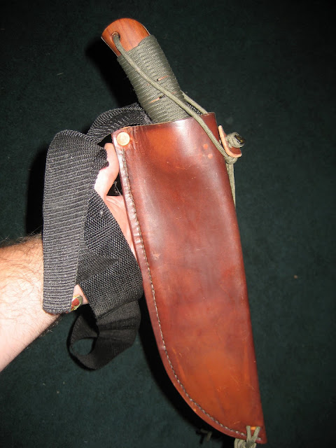

Here is mine that I made by modifying a Tramontina into a shorter 12 inch blade length, overall 18 inch length with a wooden sheath I made for it. I think it is the perfect size for all around use, but I also have a Gerber full size machete for tougher brush clearing.
